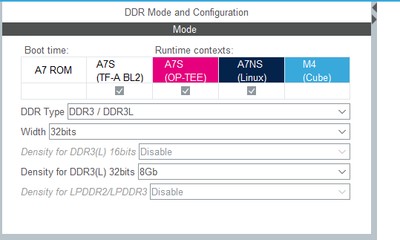

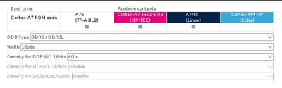

For a custom board configured in CubeMX using
STM32MP157AAA3 , UART4, 512MB DDR3L, (4Gx16) external crystal (HSE, LSE), and discrete power regulator, no PMIC, device trees were generated with CubeMX
when compiling optree errors and warnings occur.
[1] Wrong CFG_DRAM_SIZE 1024MBytes, in device-tree: 512MBytes. The TF-A and U-boot .dts files contain the same setting for memory and do not fail.
memory@c0000000 {
device_type = "memory";
reg = <0xc0000000 0x20000000>;
When setting memory to 0x40000000 instead of 0x20000000 it passes. Why is this ?

While you are trying DV5 with CubeDT generated by CubeMX you are facing OPTEE compilation error/inconsistency around DDR size parameter right ?
Did you manage to specify DDR density in CubeMX ?
Please have a look to this new release wiki page around DDR size adaptation (reduction in this case) in BSP and let me know if it can bring some light for OPTEE :
How to configure a 256MB DDR mapping from STM32 MPU Distribution Package - stm32mpu
