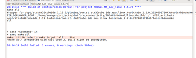

Part of my problem has been solved. I re-installed 1.19.0 of the STMCubeIDE and I am able to create an OpenSTLinux project.
However, I am having a problem building that project. It looks like the `make` may be started in the wrong folder.

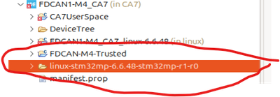

I've tried tracking it down and had no luck. However, I did come across this:
which shows a circular path to my build folder.

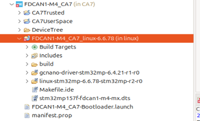

Yesterday, I uninstalled both IDE that were installed on my Linux VM. Then reinstalled 1.19.0. I reconstructed the Starter-Package and Developer-Package for the Ecosystem 6.1.0 release. I deleted and recreated my OpenSTLinux project successfully. I did notice this.
The Makefile.IDE is not correct.
~/EcoSystem/STM32MPU-Ecosystem-v6.1.0/Developer-Package/stm32mp-openstlinux-6.6-yocto-scarthgap-mpu-v25.06.11$ cat ./sources/ostl-linux/Makefile.ide
# Set default path
GCNANO_SRC_PATH ?= /home/smanger/EcoSystem/STM32MPU-Ecosystem-v6.1.0/Developer-Package/stm32mp-openstlinux-6.6-yocto-scarthgap-mpu-v25.06.11/sources/ostl-linux/gcnano-driver-stm32mp-6.4.21-r1-r0
BLD_PATH ?= /home/smanger/projects/platform_connectivity/FDCAN1-M4/CA7/linux/build
KERNELRELEASE ?= stm32mp-6.6.78-stm32mp-r2-r0
DIR_MX ?=
modules_strip:
@cd $(BLD_PATH)
$(shell rm $(BLD_PATH)/$(INSTALL_MOD_PATH)/lib/modules/$(KERNELRELEASE)/build)
$(shell rm $(BLD_PATH)/$(INSTALL_MOD_PATH)/lib/modules/$(KERNELRELEASE)/source)
@find $(INSTALL_MOD_PATH)/ -name "*.ko" | xargs $(STRIP) --strip-debug --remove-section=.comment --remove-section=.note --preserve-dates
modules_install_ide:
@make modules
@make INSTALL_MOD_PATH=install_artifact modules_install
modules_all: modules_install_ide modules_strip
gcnano_all:
@cd $(GCNANO_SRC_PATH)
@make ARCH=arm SOC_PLATFORM="st-mp1" DEBUG=0 O=$(BLD_PATH) M=$(GCNANO_SRC_PATH) AQROOT=$(GCNANO_SRC_PATH) -C $(BLD_PATH)
gcnano_clean:
@make ARCH=arm SOC_PLATFORM="st-mp1" DEBUG=0 O=$(BLD_PATH) M=$(GCNANO_SRC_PATH) AQROOT=$(GCNANO_SRC_PATH) -C $(BLD_PATH) clean
dtb_mx:
@make dtbs O="../build" KBUILD_EXTDTS=$(DIR_MX)
It looks like there are no build targes for the Linux kernel and others.

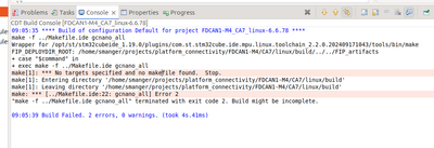

I tired to build the gcnano project. and I got this:
It leads to me believe that Makefile.ide is not constructed properly.
