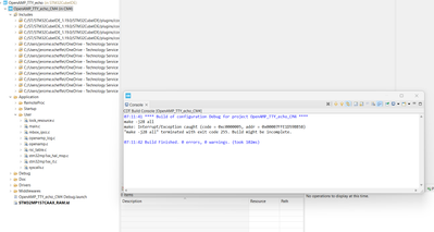

More info: When I do the build it finishes with 0 errors and warnings but does say that the build might be incomplete.

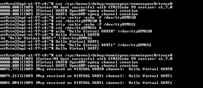

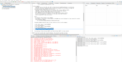

If you see you will find logs on 3. MPU SERIAL (Connected).
Here you can see the logs like this , I have used the commands present in readme.txt of this application:

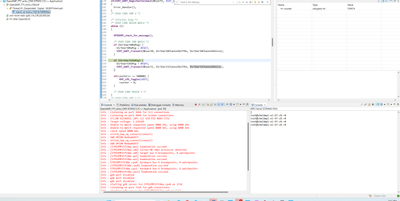

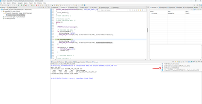

It is working as expected; logs are coming and the LED is blinking:
I am attaching the screen shot for the same.
Have you opened TeraTerm or some other software to see the logs?
On this part, there are chances that there are no files included in build.
https://github.com/STMicroelectronics/STM32CubeMP1/tree/master/Drivers/STM32MP1xx_HAL_Driver
you can check whether these files are included or not.

I am using the console that is in the STM32CubeIDE. I removed the project from the IDE and imported it again. It appears that there are files included in the build.
This is after I did the build.
