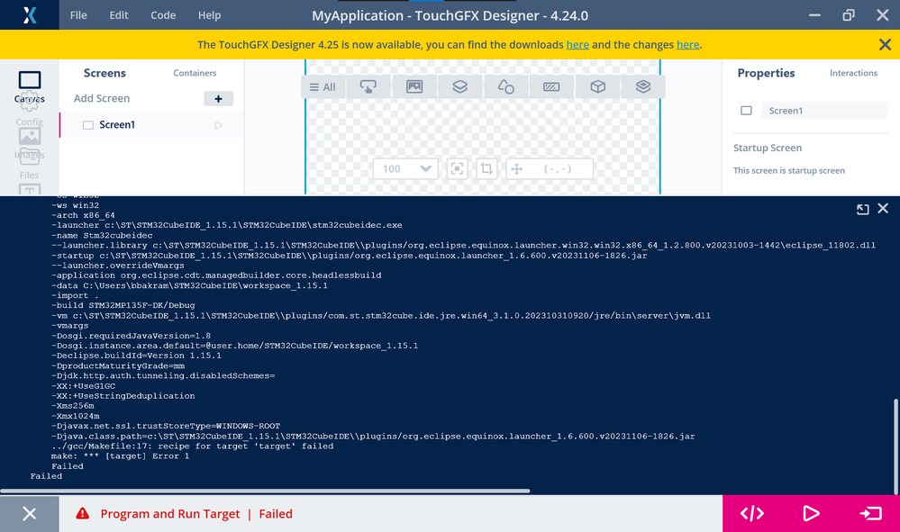

Generated the code……and clicked the "run target" as required……finally it went like, this↓
I wondered.

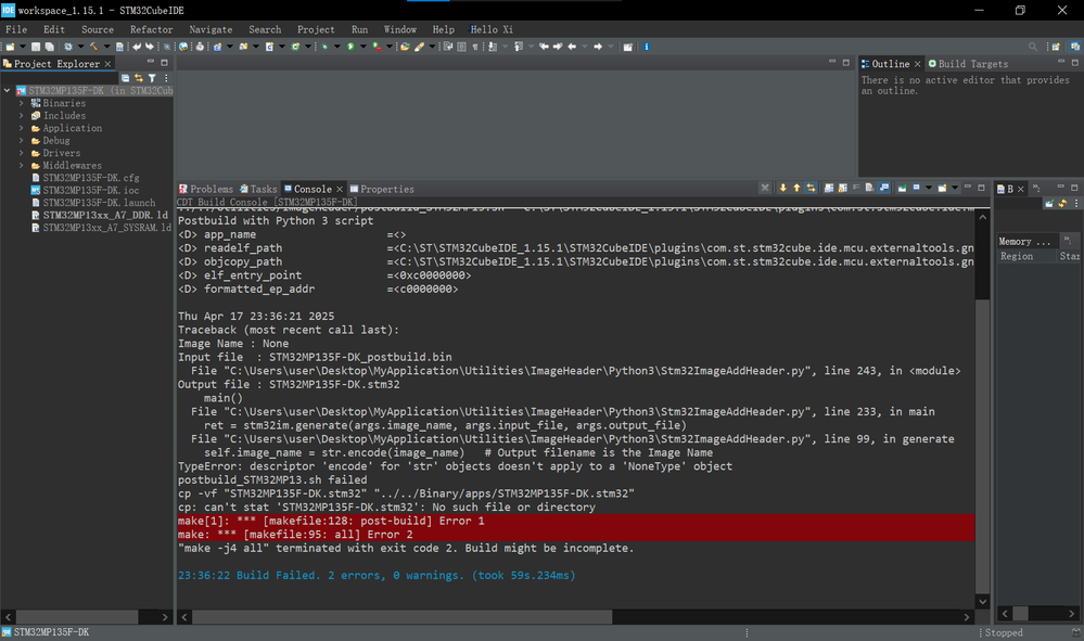

So I opened the CubeIDE project and tried to build it just in the IDE.
And unfortunately↓
I thought that it must be wrong, however, I done everything the wiki told me.
I was using my Windows 10 old laptop, and theTouchGFX version matched the addon, and I was using exactly the same IDE which the IDE cded to when the postbuild begun. Everything had been installed into their default directory. I did nothing wrong.
I tested with two of my computers, but both of them output the same bugs, which seemed like "some .py script problems".

The first issue with TouchGFXDesigner Run button is due to hardcoded syntax in the release Mp135 TBS (gcc/Makefile). Using the right path should make the Run button working.
Then for the second issue:
Issue is with the ImageGenerator module in the TouchGFX v4.24.0 release (not in the X-TOUCHGFX-MPU Add-on).
All our Cube1 based products are NOT ‘necessarily’ compatible Python v3.x. This apply to the TouchGFX ImageGenerator scripts which are released with TouchGFX v4.24.0.
It's recommended to use Python v2.7.

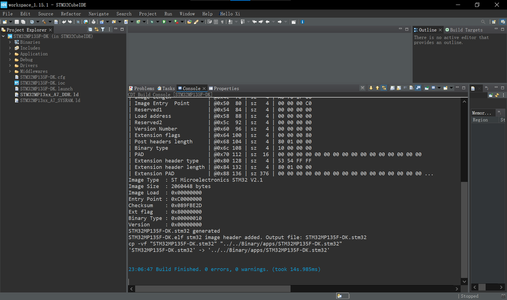

2025-05-05 8:42 AM
Hello @Olivier GALLIEN
I'm glad that the two fixes work pretty well right now.
What I had done after I received your reply:
1. Modified the workspace loaction.
2. Replaced python 3.9.8 with python 2.7.0.
Then the stm32 header was added successfully.

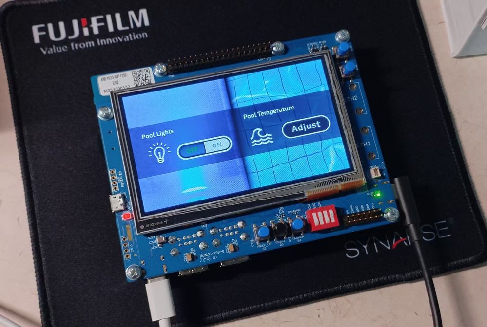

Here's the final result.
I'm working closely with the ST China Marketing Department, so I'll write an article as soon as possible to report this solution to the STM32 fans in China.
Thank you very much.
