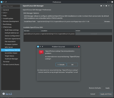

After clicking on "Apply and Close" this error shows up:
I have tried entering the SDK path directly, path of a parent folder, etc., even tried to remove the "stm32mp1-" prefix from the SDK's directory name to match exactly the name given in the error but there was no change.
There is no further information when I run CubeIDE from terminal and run into this error.

2025-05-05 4:45 AM
Thank you for pointing out this embarassing oversight.
When I installed the toolchain to the default location proposed by the installation script (/opt/st/stm32mp1/...) and tried to use this toolchain in the SDK manager, the CubeIDE gives this error:
An internal error occurred during: "OpenSTLinux Lookup".
Cannot read the array length because "setupFiles" is null
Installing the toolchain to the home folder instead seems to fix this problem.
