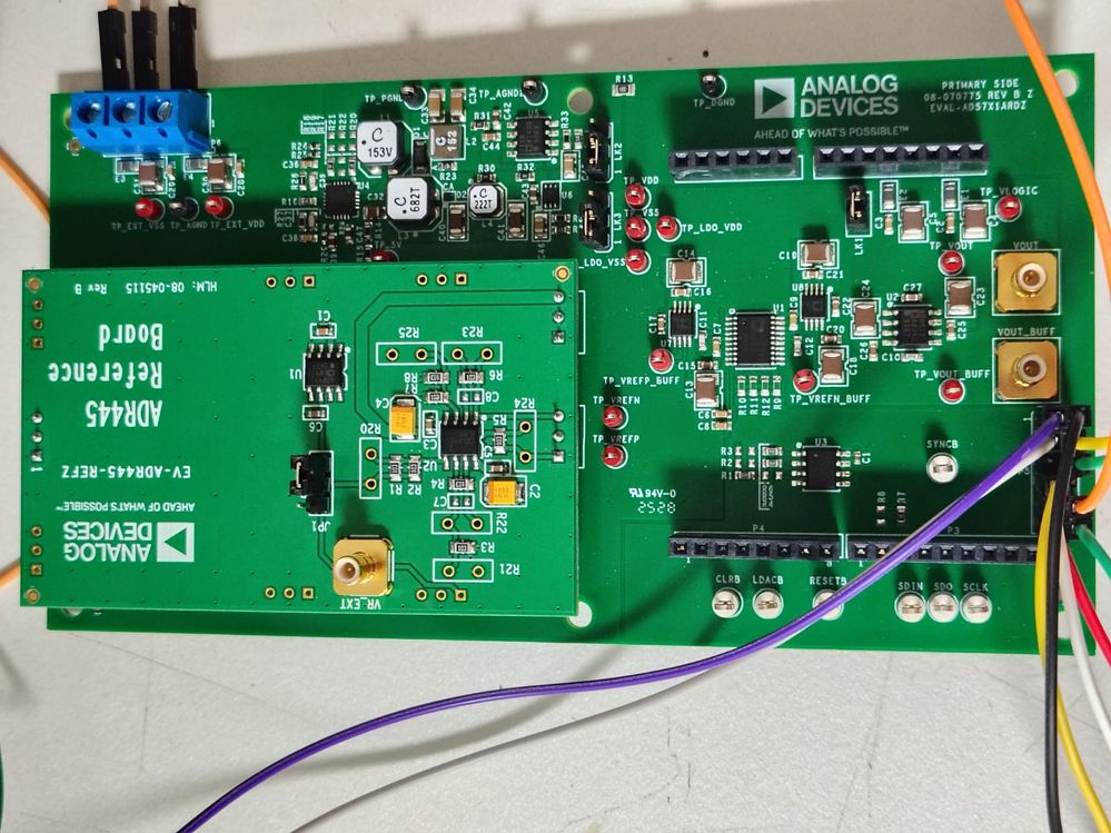

The EV-ADR445-REFZ daughter board is physically plugged into the EVAL-AD5791ARDZ board, but the AD5791 board is not getting proper reference voltages.
Questions
  1. On EVAL-AD5791ARDZ, what jumper/link settings are required for using the EV-ADR445-REFZ reference board?
  2. Should the ADR445 reference board automatically generate VREFP/VREFN when VDD/VSS are applied?
  3. Which test points should show 5 V, +10 V, and -10 V?
  4. Is ±12 V enough for generating ±10 V reference, or should I use ±15 V?
  5. Are there any required links/jumpers near LK2, LK3, LK4, or LK12 for enabling the reference path?
I have attached a photo of my EVAL-AD5791ARDZ + EV-ADR445-REFZ setup.WhatsApp Image 2026-05-27 at 1.13.44 PM.jpeg
Main issue: AD5791 VDD/VSS are correct, but VREFP/VREFN stay around 0.8 V and ADR445 5 V TP is not coming up.
