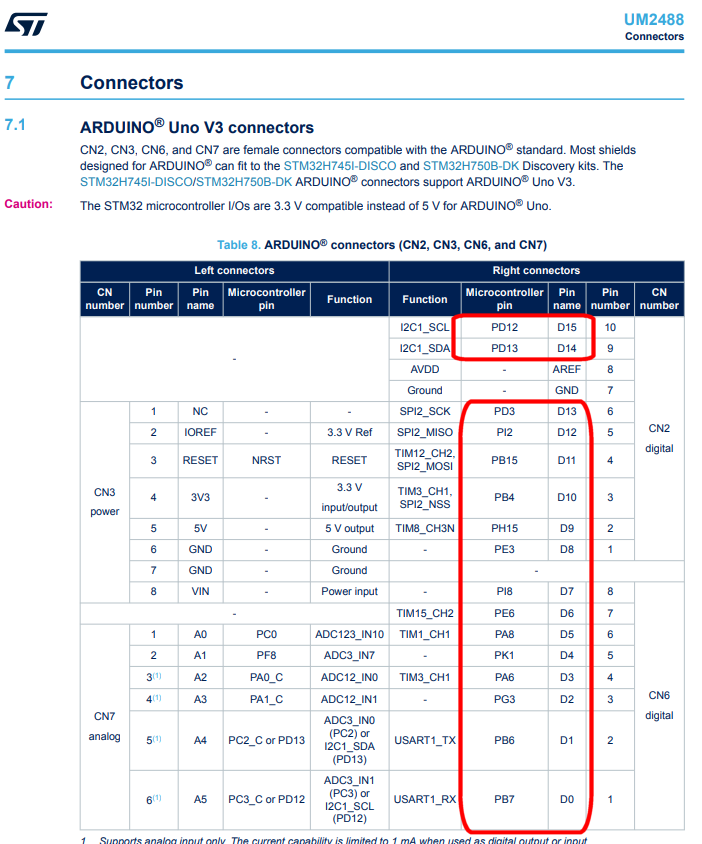

2024-06-05 8:43 AM - edited 2024-06-13 1:24 AM
Here they are:
Here they are:

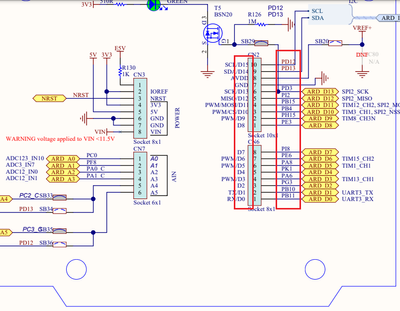

You can find the correspondence D0-D15 / GPIO pins in the board's schematics:
But also in UM2488 / Table 17. STM32H745I-DISCO and STM32H750B-DK I/O assignment: search for ARD_DXX. Example for D3 search for ARD_D3.

So if I understand correctly, PIN D0 is port GPIOB and GPIO_PIN7? Because I tried to use the exact page you shared but lack of experience (first time using STM32) did not make it so clear for me
2024-06-06 1:16 AM
Hello @kyrkap ,
I think there is a discrepancy between the schematics and Table 8 regarding D0 and D1:
As shown in the schematics I shared in my previous comment:
D0 : GPIOB/pin11, D1: GPIOB/pin10
while in table 8:
D0: GPIOB/pin7, D1: GPIOB/pin6
So try PB11/PB10 for D0 and D1.

2024-06-06 1:45 AM
@kyrkap wrote:So if I understand correctly, PIN D0 is port GPIOB and GPIO_PIN7?
Yes: "PB7" means "pin (or bit) 7 on GPIO Port B"
@kyrkap wrote:I tried to use the exact page you shared but lack of experience (first time using STM32) did not make it so clear for me
But note @mƎALLEm's reply - it seems there might be an error in the table ...
