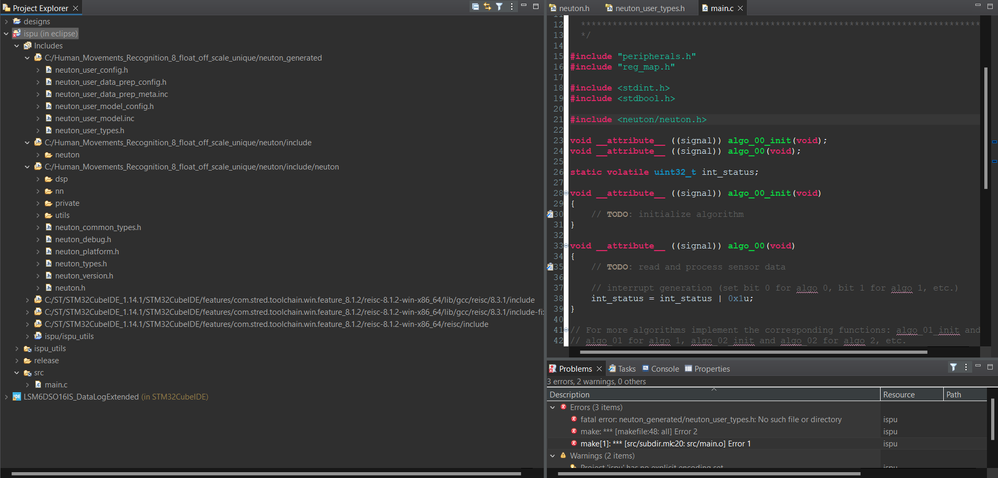

Hi, I am having trouble building my ISPU project. When I attempt to build i get 3 errors:
1- fatal error: neuton_generated/neuton_user_types.h: No such file or directory ispu line 13, external location: C:\Human_Movements_Recognition_8_float_off_scale_unique\neuton\include\neuton\nn\neuton_nn.h C/C++ Problem
2- Description Resource Path Location Type
make: *** [makefile:48: all] Error 2 ispu C/C++ Problem
3- Description Resource Path Location Type
make[1]: *** [src/subdir.mk:20: src/main.o] Error 1 ispu C/C++ Problem
I have included neuton_generated already but it doesn't seem to want to find it
Any Ideas?

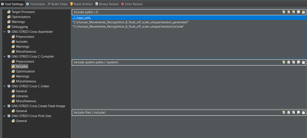

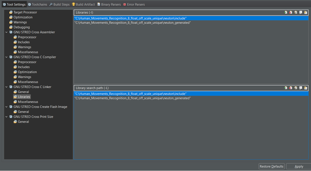

@Cesar-Luna wrote:Hi, I am having trouble building my ISPU project. When I attempt to build i get 3 errors:
So it's not finding the neuton_nn.h file
Does that file actually exist in that location on your system?
That's a relative path, so it has to be relative to somewhere that the compiler is looking - ie, somewhere in your Include Paths.
Is it?
Rather than confuse the issue with relative paths, why not just add the actual path to your Include Paths?
