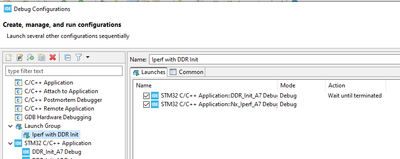

,Dear @DBELL.1 ,
Thanks for answer. Yes I mean "RUN" as green button with PLAY symbol on it.
So I really need to start debug any project even I need only to run them ?
E.g. To run some application (NetxDuo ... projects), we must first run DDR_Init_A7 to initialize DDR) I make launch script, but I must still manually run DDR_Init each time..
So there did not exist "better" way to execute project without debugging ? I don't mean populate final binary to flash memory...
Best Regards
Radim
