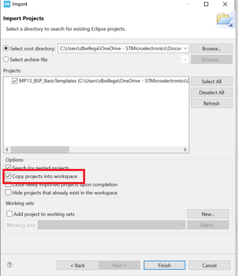

2024-02-22 8:09 AM
Hello @ravo ,
I confirm your point because I did this:
then I had the same errors as you
So I report the point, it could be due to the path of sources which are not achievable by eclipse
And we do not recommend to use it.
BTW it works well without ckeck this option.
rgds,
David
2024-02-22 8:43 AM - edited 2024-02-23 1:25 AM
Dear @DBELL.1
thanks for answer. Yes if I do it without this checkbox it works normally.
If I compare not working project (project files .cproject are same) bud generated makefiles here contain one more line in SUBDIRS secion "Drivers/CMSIS/Device/ST/STM32MP13xx/Source/Templates/gcc \"
sources.mk
SUBDIRS := \
Application/User \
Drivers/BSP/STM32MP13xx_DISCO \
makefile contain
-include Drivers/CMSIS/Device/ST/STM32MP13xx/Source/Templates/gcc/subdir.mk
and in this subdir.mk are wrong paths which did not exists
C_SRCS += \
C:/Users/Drivers/STM32MP13xx_HAL_Driver/Src/stm32mp13xx_hal.c \
C:/Users/Drivers/STM32MP13xx_HAL_Driver/Src/stm32mp13xx_hal_dma.c \
C:/Users/Drivers/STM32MP13xx_HAL_Driver/Src/stm32mp13xx_hal_dma_ex.c \
And in working project this subdir.mk did not exist/ //Corrected later 2024-02-23: file subdir.mk exists here, but with corrected path inside.
Maybe this could cause problems...
I just tried manually copy project and open from new location but it will produce same errors.
Project structure are same... different only in Debug subfolder ( where is some subdir.mk files is wrong not-existing paths beginning C:/Users/Drivers/... for example "C:/Users/Drivers/CMSIS/Device/ST/STM32MP13xx/Source/Templates/gcc/startup_stm32mp135c_ca7.c"
So this is problem to use this template as "start project"
Best Regards Radim
