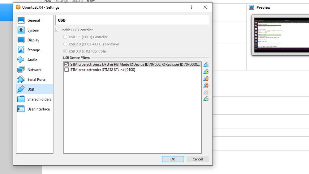

2020-11-26 6:57 AM
Hi PatrickF ( ST Employee )
Thanks for your reply.
Its working everything really thanks for your support.
after adding VM in 'USB download gadget@Device ID /0x500, @Revision ID /0x0000)' and select in VM.
like
Thanks.
