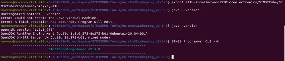

The installation PATH of STM32CubeProgrammer is not the good one as expected.
You have to install in "$HOME/STM32MPU_workspace/STM32MPU-Tools/STM32CubeProgrammer-2.5.0/" and add the binary path to path environment variable "export PATH=$HOME/STM32MPU_workspace/STM32MPU-Tools/STM32CubeProgrammer-2.5.0/bin:$PATH"

I am just installer STM32Cubeprogrammer 2.5.0 version in Ubuntu 20.04

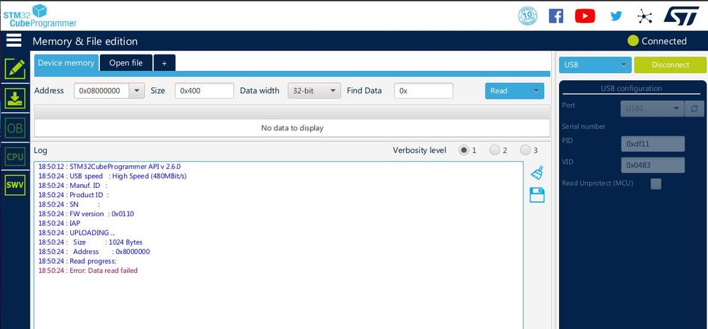

Hi Olivier GALLIEN (ST Employee)
Thanks its working fine.
when I launch and connect the device it shows like
I installed USB port also.
I can able to install and connecting is ok but when i connect the device it showing like this please once check it.
Thank

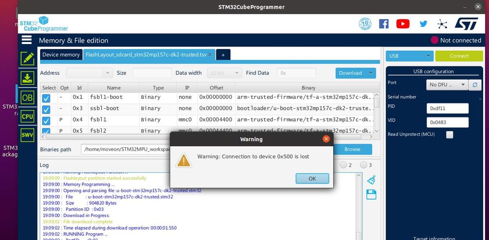

2020-11-24 5:41 AM
please check i getting this warning
2020-11-24 5:41 AM
2020-11-24 5:42 AM
When i flash the image in between connection is loss
