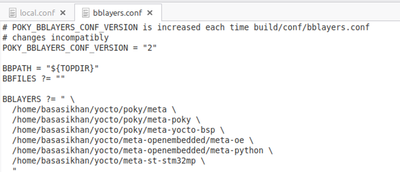

Hi, I'm new to yocto project, I'm trying to bitbake core-image-minimal image in yocto in stm32mp157d-dk1(scarthgap) ,by editing the bblayers.conf and local.conf in image, its successfully build and flashed into SD card , but I'm trying to boot device then it failed. I found in bootfs sector there was no files in it. I tried to build with kirkstone branch and it worked well, and then I tried to bitbake with scarthgap again and again. I used Ubuntu 24.04 and Linux mint 22.03, but scarthgap branch had the same problems.I wanna know the reason. BIG THX.

my bblayers file
