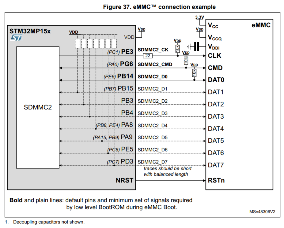

Hi @PatrickF ,
I'm using those 3 pins for SDMMC2 and BootROM would use them by default.
SDMMC2_D0 - PB14
SDMMC2_CMD - PG6
SDMMC2_CLK - PE3
Do I need to change OTP, maybe no?
I wanted to say that my other pins (D4-D7) are not default for SDMMC2 (picture below). Are these SDMMC2 pins set with subsequent device tree-s (tf-a, u-boot, kernel dtb)?
Thanks in advance,
Nenad
2020-12-09 11:22 PM
Sorry, I misread your first post.
In that case, no need to program OTP, just define the pins in Device Tree for TF-A, uBoot and Linux.
Regards.
