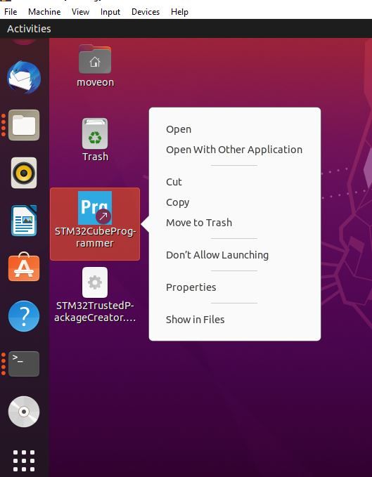

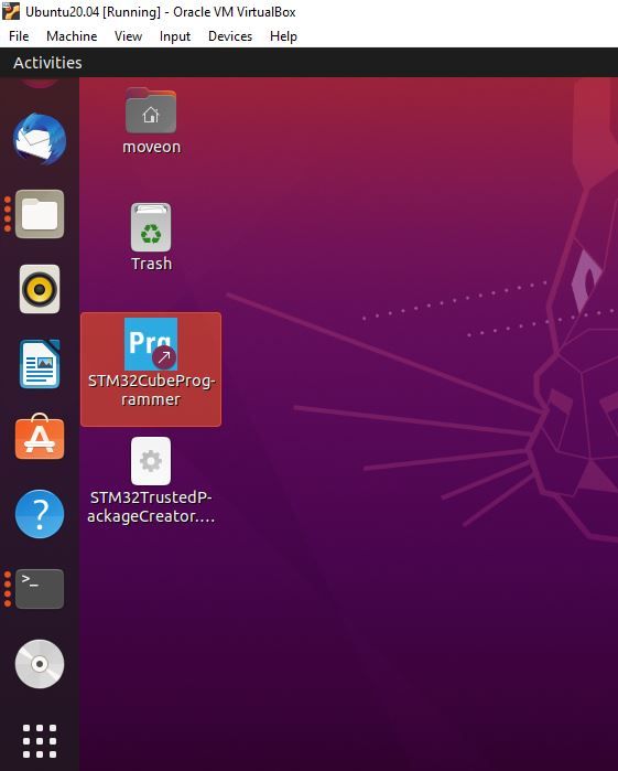

2020-11-23 8:54 PM
HI Olivier GALLIEN (ST Employee)
I am using Ubuntu 20.04 version.
on the desktop icon is there but it doesn't open when i am click to "Allow Launching"
it shows like
Thanks

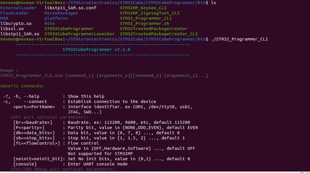

2020-11-23 11:49 PM
this information i am getting please check it.
Thanks
