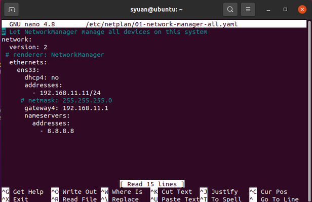

The Static IP settings of my computer are as follows

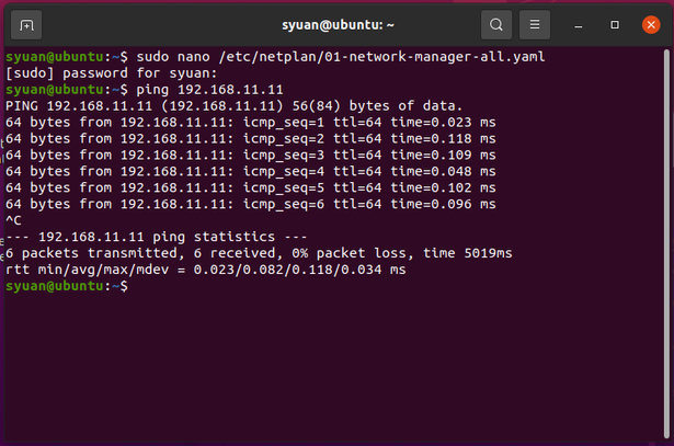

As follows, My computer can ping itself

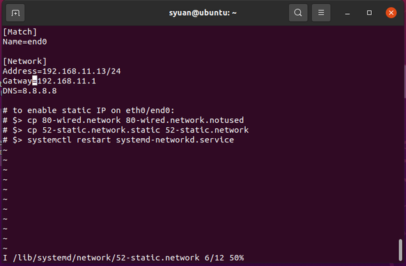

Then the Static IP (/lib/systemd/network/52-static.network) of my STM32MP135F-DK is set as follows

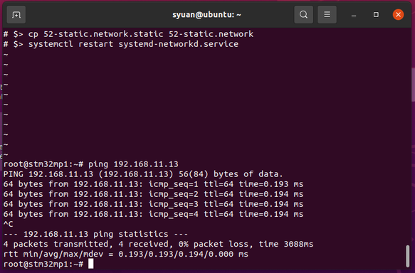

As follows, My STM32MP135F-DK also can ping itself

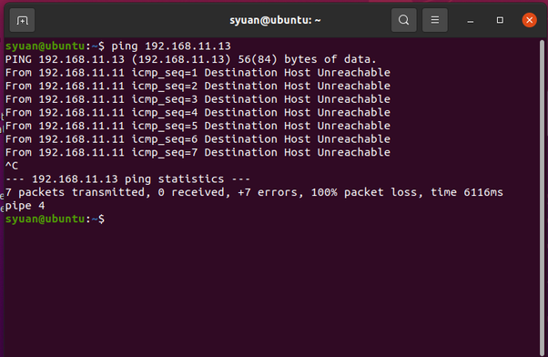

Why can't my computer ping STM32MP135F-DK?

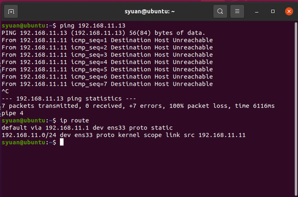

This is my comouter ip route, Why can’t I see the ip route of STM32MP135F-DK?
