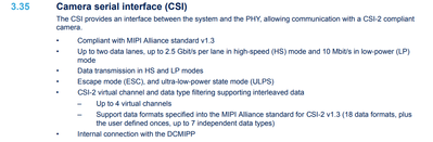

SD do provide an internal peripheral for CSI-2:
https://wiki.st.com/stm32mpu/wiki/CSI_internal_peripheral

2024-10-08 2:08 PM
Dear @Will_Robertson ,
You can refer to our STM32MP25 : Arm® based dual Cortex®-A35 1.5 GHz + Cortex®-M33 MPU, AI, 3D GPU,
video encoder/decoder, TFT/DSI/LVDS, USB 3.0, PCIe
It supports natively Camera CSI-2
Hope it helps you.
STOne-32.
