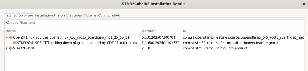

I tried desperatly to follow this tutorial from ST...
In the CubeIDE :
MANIFEST_VERSION = openstlinux-6.6-yocto-scarthgap-mpu-v26.02.18
KERNEL_DT = ./DeviceTree/Bouton_RGB/kernel
OPTEE_DT = ./DeviceTree/Bouton_RGB/optee-os
UBOOT_DT = ./DeviceTree/Bouton_RGB/u-boot
TFA_DT = ./DeviceTree/Bouton_RGB/tf-a!SESSION 2026-03-06 13:59:17.516 -----------------------------------------------

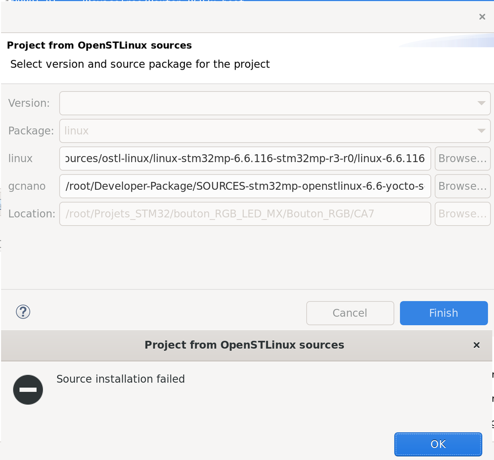

When I right-click on the A7 project > open an OpenSTLinux Project and fill the paths :
I can't manage to get the version loaded in the first field, as in the tutorial !
That's why I'm asking for help on these questions :
- Should the plugin version be 26_02_18 instead of 25_06_11 ?
- Does someone have an idea of why the version is not loaded and ultimately the "Source installation failed" ?
