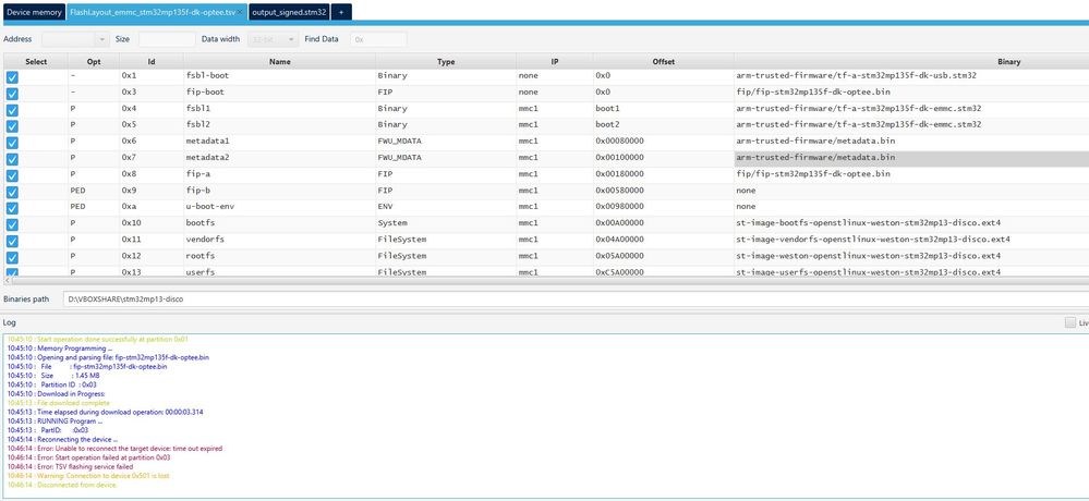

STM32CubeProgrammer's screenshot is like below.
Would you give an advise?

The main difference is i2c4 and i2c5.
OPTEE doesn't probe i2c5 and pmic looks doesn't work.
Why isn't i2c5 probing happening?
