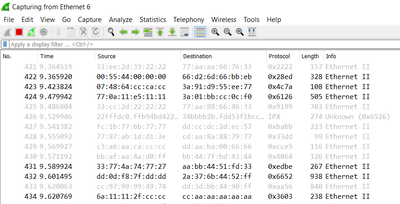

After enabling the clock, eth2 wakes up. In wireshark, I can see data being transferred and the interface's LED blink. The thing is, the visible data is an uncontrolled spam of bytes that does not stop.

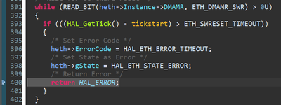

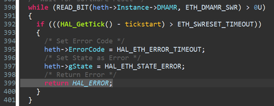

I am also getting an error in this section of code:
The SWR bit is always 1, so the eth2 can't be reset.

My clock was configured to 50 MHz, but after reading the frequency with an oscilloscope it was exactly more than 51 MHz. After configuring PLL4 to work with HSE instead of HSI, there is no byte spam anymore.

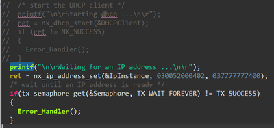

When I debug project It freezes in app_netxduo.c on line tx_semaphore_create(&Semaphore, "DHCP Semaphore", 0); in MX_NetXDuo_Init
Solution:
Comment out the DHCP section of code and set your ip manually in IPInstance. Changing the IP will call a Callback function which unlocks the Semaphore.

10. Now it will hang in HAL_StatusTypeDef HAL_ETH_Init(ETH_HandleTypeDef *heth)
stm32mp13xx_hal_eth.c
/* Wait for software reset */
while (READ_BIT(heth->Instance->DMAMR, ETH_DMAMR_SWR) > 0U)
if (((HAL_GetTick() - tickstart) > ETH_SWRESET_TIMEOUT))
/* Set Error Code */
heth->ErrorCode = HAL_ETH_ERROR_TIMEOUT;
/* Set State as Error */
heth->gState = HAL_ETH_STATE_ERROR;
/* Return Error */
printf("6 ERROR."); // I just put info to UART terminal
return HAL_ERROR;
I also tried to start with STATIC ADDRESS and disable all DHCP inititializationprior to write this comment, for ETH1 it is working correctly
ret = nx_ip_create(&IpInstance, "Main Ip instance", STATIC_ADDRESS, MASK_ADDRESS, &AppPool, nx_stm32_eth_driver,
but for ETH2 when I do this it will pass all initialization but after I tried to get IP number it will get 0.0.0.0.
nx_ip_address_get(&IpInstance, &IpAddress, &NetMask);
