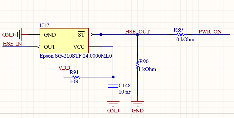

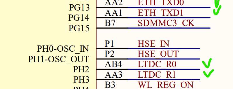

I have attached the schematic. Just tell me if I'm missing something. I have included:
2024-05-07 11:38 AM

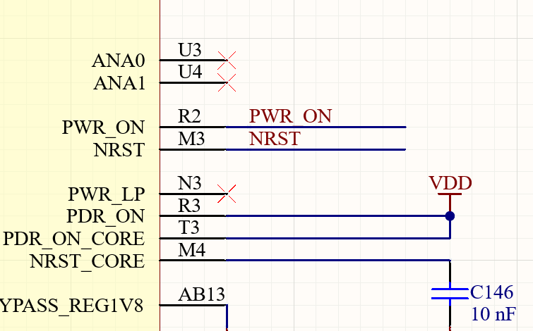

Hi @PatrickF
Can you explain why my PWR_ON won't have any actions in my schematic?

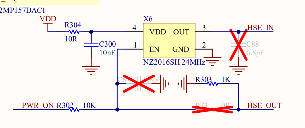

This is from my board.

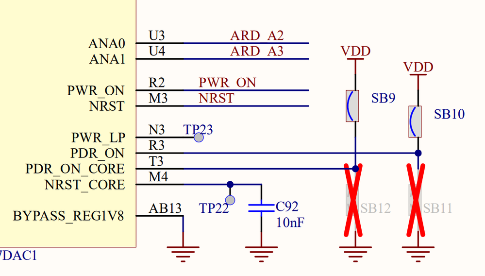

This is from the dev-kit. I assume that the zero-ohm resistor should be removed and replaced with a track only. But the capacitors should not be replaced with a track.
