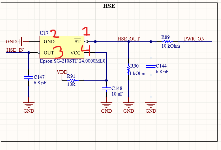

I have attached the schematic. Just tell me if I'm missing something. I have included:

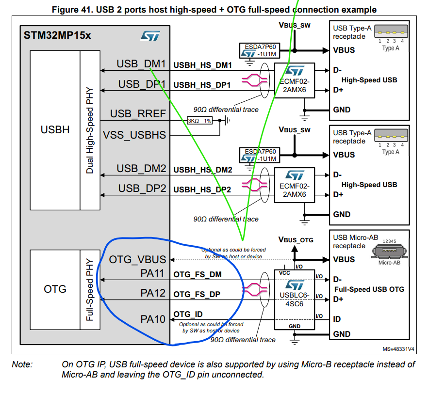

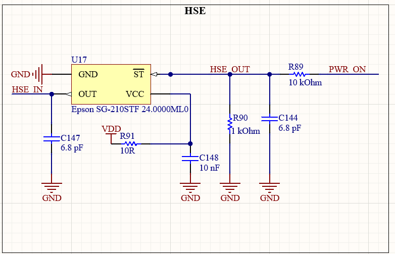

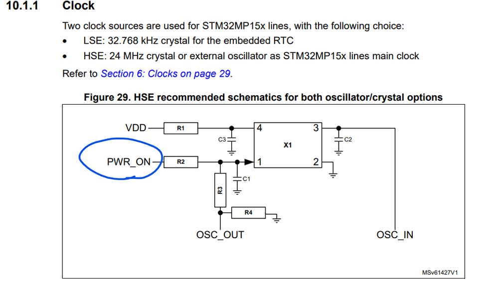

Btw, in your schematics, you might have issues around 24MHz oscillator as you need to have HSE_OUT =0 to allows BootROM autodetection of digital bypass while the oscillator usually need a logic 1 to start (i.e. PWR_ON).

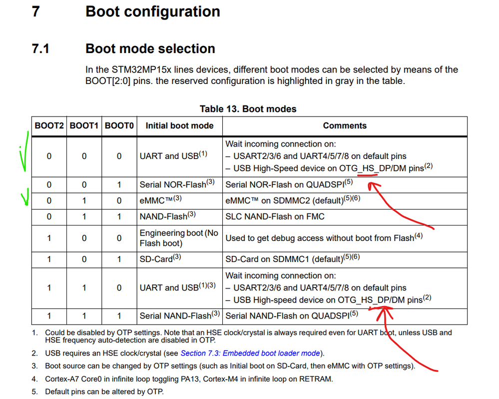

OTG_FS_DN/DP could be easily replaced by USB_DP2/DM2 to get high-speed and Flashload capabilities.

>> You should use CubeProgrammer on a PC connected to OTG high-speed port (at least USB_DP2/USB_DM2 + ground are needed).
Ok! I assume that CubeProgrammer is the flashing-tool? Right? It will flash in the operative system onto eMMC?
By the way! I'm using OTG_VBUS -> VBUS, OTG_FS_DM -> D-, OTG_FS_DP -> D+, OTG_ID -> ID to a Micro USB connector, instead of USB_DP2/USB_DM2. Is that prefered?
I have followed the schematic from AN5031.

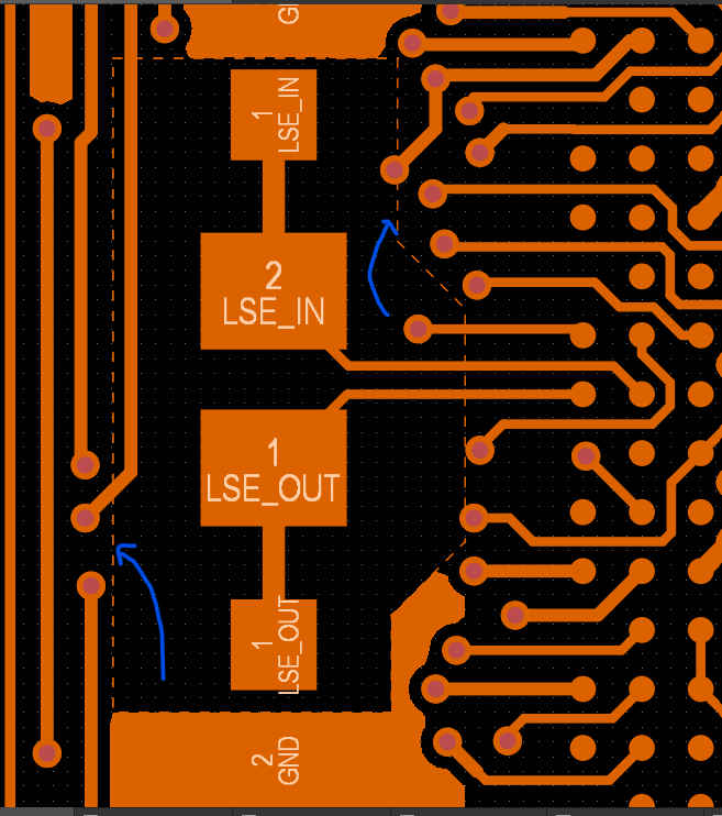

Also I have made a cut for the LSE crystal.

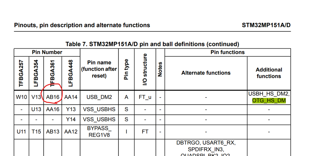

But is not OTG_FS important if I want to flash the eMMC with the operative system(Linux) via CubeProgrammer?
I have not found any OTG_HS_DN and OTG_HS_DP.
Edit:
I found that DM2_DP is pin AB16 and DM2_DN is AC16!
I will change OTG_FS_DP/DM to OTG_HS_DP/DM. Thank you for noticing that!
2024-04-30 3:00 AM

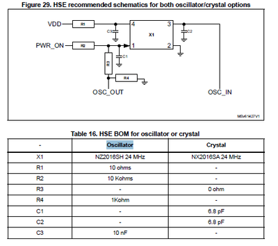

It seems the HSE oscillator is not wired as expected from AN5031 (PWR_ON and OSC_OUT are never linked, either R2 or R3 is open)
Regards
2024-04-30 12:12 PM - edited 2024-04-30 12:35 PM
It's routed as the Dev-kit example. I have following the AN5031 as you see. No R0 resistors. Oh! I see, I need to remove the 6.8 pF capacitors?

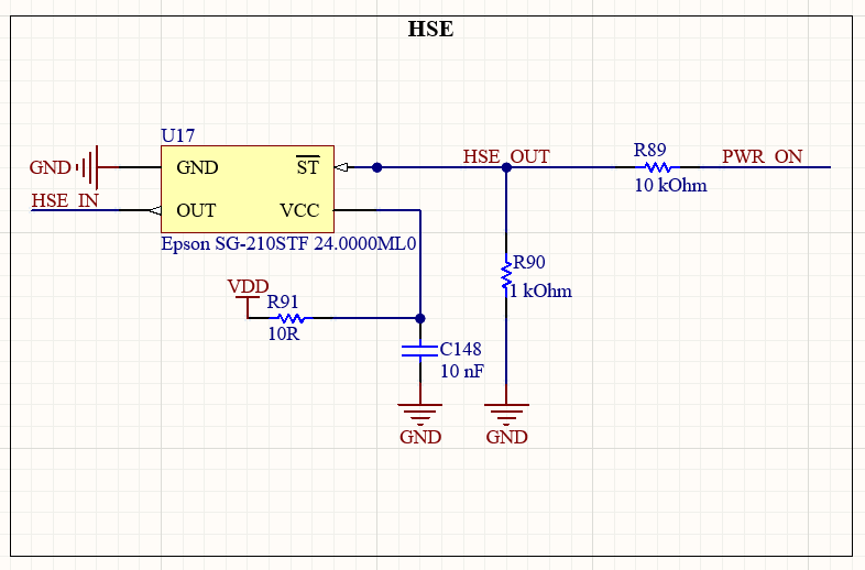

Hi.
This is still not OK IMHO.
Regards.
2024-05-02 12:09 AM
But it's exactly the same as the board STM32MP157F-DK2.
VCC has a low pass filter of 10 nF and 10 Ohm.
HSE_OUT is connected to ST/EN.
Just like the STM32MP157F-DK2.
So I don't see what's wrong.

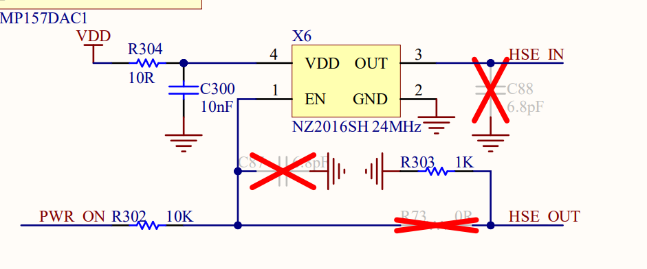

2024-05-02 12:29 AM
Not Really, please check carefully.
on STM32MP157F-DK2
- HSE_OUT is connected to ground with 1K to tell BootROM we are in digital bypass mode (i.e. external digital clock on HSE_IN)
- Oscillator enable (EN) is connected to PWR_ON (to enable oscillator at power up, but shutdown it during low power modes to save power)
- In all cases, HSE_OUT and PWR_ON have no electrical connections on PCB (either one or the other resistor is not present).
In your schematics, I see HSE_OUT grounded with 1k (OK), but oscillator Enable will always receive a 0 (as 1K to ground) and so will never start.
PWR_ON will not have any action in your schematics.
In your schamtics, you have to move the HSE_OUT and the 1K out of oscillator scope.
Regards.
2024-05-02 3:01 PM
Hi @PatrickF
Yes.
No. The EN is connected to HSE_OUT and a 10 kOhm resistor and 1 kOhm resistor, if we looking at the reference design from ST.
I have not connected HSE_OUT and PWR_ON, as you can see in my schematics.
But HSE_OUT is connected to 10 kOhm resistor and that resistor is connected to PWR_ON.
Why not?
But then I don't following the reference design from AN5031.
Or do you mean that I should ship the pull-down of 1 kOhm resistor and not connect HSE_OUT to EN? Only PWR_ON to 10 kOhm resistor and that resistor to EN?
