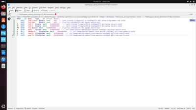

Be it that I use STM32CubeProg or the STM32_Programmer_CLI terminal interface the FlashLayout_sdcard_stm32mp157f-dk2-optee.tsv is not found despite the path being correct. Yet I am able to flash tf-a-stm32mp157c-dk2-optee-programmer-usb.stm32 0x01 or tf-a-stm32mp157f-dk2-optee-programmer-usb.stm32 0x01 using the terminal which was the first value in a sequence of the .tsv file (see kate as an example). The same conundrum occurs using STM32CubeProg. Might you suggest how I might resolve this problem - be it in establishing a USB connection or flashing the sd card using a different approach? Thanks in advance for your assistance. Much appreciated.

Patrick thanks for your response. I had previously followed the link that you provided to no avail - since then I have corrected the paths to the values within the .tsv files and I am now working towards the inspection of the UART log files. Regardless I have a question?  In adjusting the paths within the .tsv am I screwing up a structure that is causing timeout errors?
