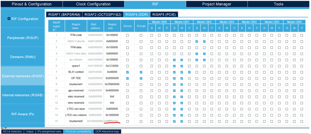

Dear all I was setting up the RISAF4 for STM32MP257, however, the partition with name "linuxkernel2" has a glitch where its size shows as given
Which is beyond the size of my LDDR4 set to 8Gb.
How to solve it? A quick reply will be appreciated.

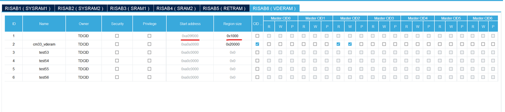

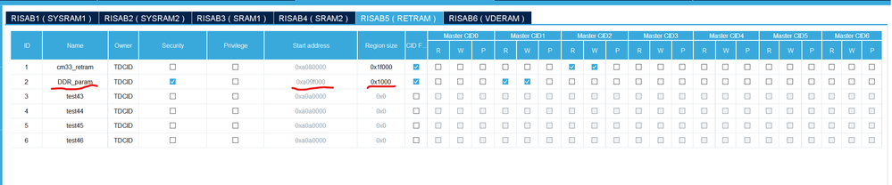

There are actually two glitches :
the first one is what I reported. The second one is in RISAB 5 and 6. The same address appears both in RISAB 5 and 6 and hence might cause overlap of memories.
Moreover, I have a question that in EV1 device-tree there is no linuxkernel1 and 2 partition. below I have shown the generated device tree by cubeMX and the one from EV-1 Device Tree:
Generated:
linuxkernel1: linuxkernel1@84000000 {
reg = <0x0 0x84000000 0x0 0x76800000>;
no-map;
/* USER CODE BEGIN linuxkernel1 */
/* USER CODE END linuxkernel1 */
gpu_reserved: gpu-reserved@fa800000 {
reg = <0x0 0xfa800000 0x0 0x4000000>;
no-map;
/* USER CODE BEGIN gpu_reserved */
/* USER CODE END gpu_reserved */
ltdc_sec_layer: ltdc-sec-layer@fe800000 {
reg = <0x0 0xfe800000 0x0 0x800000>;
no-map;
/* USER CODE BEGIN ltdc_sec_layer */
/* USER CODE END ltdc_sec_layer */
ltdc_sec_rotation: ltdc-sec-rotation@ff000000 {
reg = <0x0 0xff000000 0x0 0x1000000>;
no-map;
/* USER CODE BEGIN ltdc_sec_rotation */
/* USER CODE END ltdc_sec_rotation */
linuxkernel2: linuxkernel2@100000000 {
reg = <0x00000001 0x00000000 0xffffffff 0x00000e89>;
no-map;
/* USER CODE BEGIN linuxkernel2 */
/* USER CODE END linuxkernel2 */
/* USER CODE BEGIN reserved-memory */
/* USER CODE END reserved-memory */
