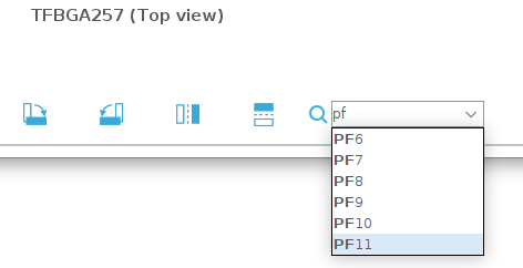

- pins 80..95 on pin controller "pinctrl" is mapped to GPIO line 0..15
Which is not possible because this package TFBGA257 doesn't have 16 pins mappable to gpiof, but only 6 pins as indicated by the property "ngpios = <6>" and as visible in the datasheet and CubeMx:
While if we look at the default configuration that you had before:

2022-06-29 10:19 AM
Hello @Moises Araya,
I attach to this post a patch for linux that fixes the display of the gpioinfo command.
Regarding the modifications that you made, I'm not a gpio expert but for me this is not the right things to do.
