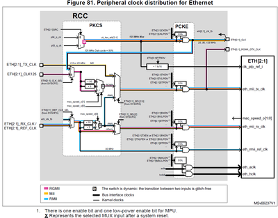

this kind of error usually come from lack of clock going to ETH IP (eth_mii_tx_clk and eth_mii_rx_clk).
Apart settings in RCC, please have a look to this figure from RM0475 and set SYSCFG according to your HW board setup to ensure correct clock paths are selected.
AN5474 could also help.
