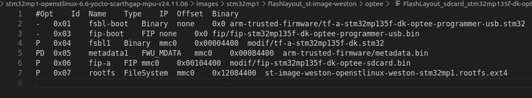

Modified the TSV in the starter package to replace u-boot.bin with my Linux image and updated the FIP entries as follows:
2. Observed output:
