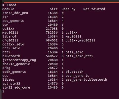

We inserted the lkm module stm32_ddr_pmu.ko using modprobe. The lsmod lists the stm32_ddr_pmu

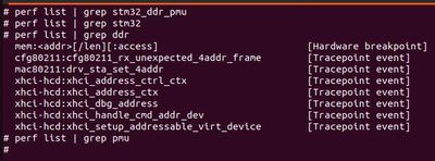

perf list does not show the stm32_ddr_pmu
