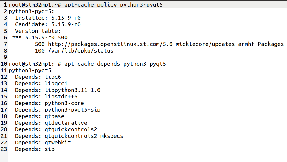

My installed python3-pyqt5 package is:
root@stm32mp1:~# apt-cache policy python3-pyqt5
python3-pyqt5:
  Installed: 5.15.9-r0
  Candidate: 5.15.9-r0
  Version table:
 *** 5.15.9-r0 500
        500 http://packages.openstlinux.st.com/5.0 mickledore/updates armhf Packages
        100 /var/lib/dpkg/status
root@stm32mp1:~# apt-cache depends python3-pyqt5

Hello @Jean-Marc B
I am grateful for your response and I received the following output.
And still i am getting the following error.

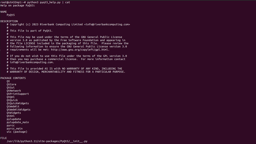

Hi @Shail
That's disturbing!
Would it be possible to perform the following commands please?
root@stm32mp1:~# cat > pyqt5_help.py << EOF
#!/usr/bin/env python3
import PyQt5
help(PyQt5)
root@stm32mp1:~# python3 pyqt5_help.py | cat
This is my output from a fresh installation of OpenSTLinux 5.0 with additional installations of qtwayland and python3-pyqt5 packages:

Hello @Jean-Marc B
Your response is greatly appreciated. As you pointed out, I attempted and obtained the following outcome.
Thanks and Regards,
Shail
Hi @Shail
Ok, the sip entry is missing in your data while available in my output.
