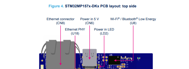

from manual UM2637 :
the STPMIC ds :

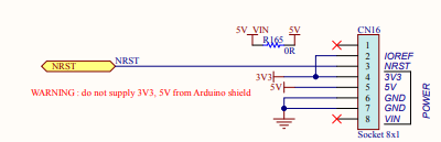

see circuit:
CN6 is power in, 5V (3A) .
warning...

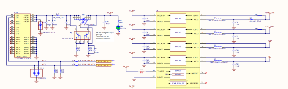

No. See circuit diagram... usb-c -> 5V -> to STPMIC1A .
No fast charging - only fast killing. :)

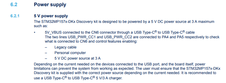

Come on, i just looked at the manual -> power -> and showed it here.
And if you you look at the circuit - you see the CN6 -> 5V input . Nothing else there.
So if the charger puts out 5V , everything fine. But if it tries fast charge... ok. you know now.
manual says:
