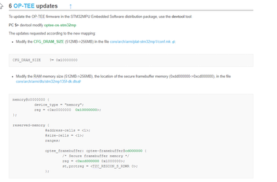

ST posted the WIKI on Step 12
but it did not solve my problem
and appears to be related to
And questions 1 to 4 above still stand. (Item 5 was probably a mistake i changing the header manually)
2023-09-17 7:23 PM
Hi Olivier,
Thank you for posting the guidance. ( How to configure a 256MB DDR mapping from STM32 MPU Distribution Package - stm32mpu ) After the compilation, I need to copy the result files to SD card. Btw, according to the tutorial in ST wiki ( How to cross-compile with the Developer Package - stm32mpu ), I found the same "fip-stm32mp135f-dk-optee.bin" should be copied to the sdb5 partition three times as below. Could you please confirm the destination partition is correctly noted in the tutorial? It's hard to understand how it can work. Thanks.
Best Regards,
Jeff

According to the initial error log, I set reserved-memory for optee as below. However, the bootlog still shows "TEE load address @ 0xde200000" with the TZC permission failure. Enabling STM32MP1_OPTEE_IN_SYSRAM didn't help. Please review the below boot log.
optee-os-stm32mp-3.16.0-stm32mp-r2/core/arch/arm/dts/stm32mp135f-dk.dts
reserved-memory {
#address-cells = <1>;
#size-cells = <1>;
ranges;
optee_framebuffer: optee-framebuffer@fd000000 {
/* Secure framebuffer memory */
reg = <0xfd000000 0x1000000>;
st,protreg = <TZC_REGION_S_RDWR 0>;
u-boot-stm32mp-v2021.10-stm32mp-r2/arch/arm/dts/stm32mp135f-dk.dts
linux-5.15.67/arch/arm/boot/dts/stm32mp135f-dk.dts
reserved-memory {
#size-cells = <1>;
ranges;
optee_framebuffer@fd000000 {
no-map;
optee@fe000000 {
reg = <0xfe000000 0x2000000>;
no-map;
Best Regards,
Jeff
