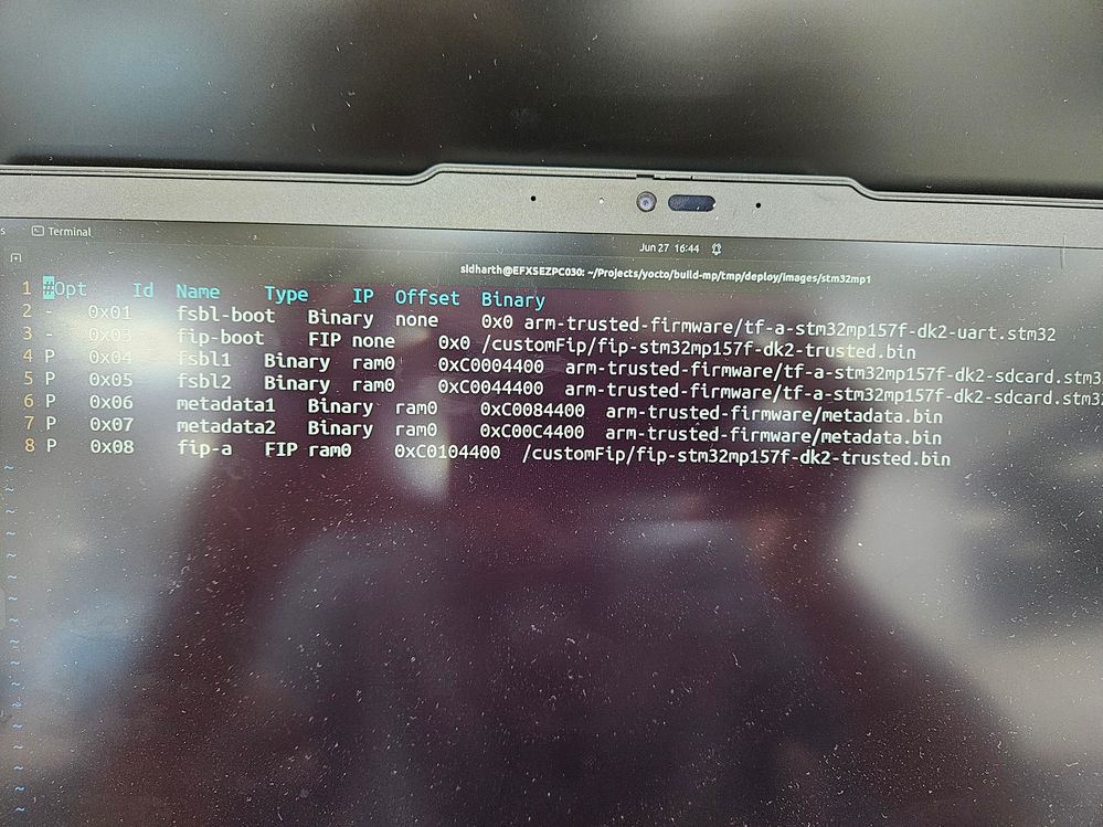

I have used the cube programmer to load fsbl1, fsbl2 and fip.bin onto DDR3 from forced uart boot mode. I am trying to execute the loaded files from RAM itself and get access to the u-boot console.
The files i have used were taken from the build directory of core-image-minimal build that was created using yocto.
Ive attached the .tsv file i used for the cube programmer.

Hi @Sidharth
I guess what you are looking for is this How to load U-Boot with STM32CubeProgrammer - stm32mpu
Hope it help
