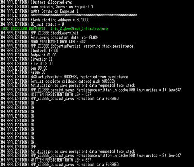

I read the AN5492 and the Zigbee_OnOff_Router_NVM example. My current code is globally a copy/paste of the Zigbee_OnOff_Router_NVM example with one GPIO control in the On/Off callback. The clusters I'm using are Commissioning (Server) and On/Off (Server), both on the same endpoint. While I can still join my network if the NVM is cleared from any Zigbee-related value, once the connection is successful, if I reboot the device, the STM32 can successfuly connect but is only controlable via Zigbee for a short time: Especially between two persistency callback call (see below):
As you can see on this picture, the Zigbee commands On/Off are successful between the two notifications but once the second on is called, it stops responding to any command...

Actually, I don't understand why there is this second call... As far as I understand, the first one is caused by the ZbStartupPersist ending with SUCCESS (as described in the ZbStartupPersist function -- zigbee_core_wb.c) but the second one, I can't understand for now.

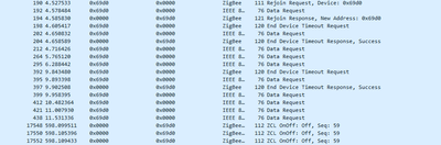

Please find attached a PCAP with selected packets between coordinator (0x0000) and end-device (0x69d0). As we can see on the picture below (full file attached), the device request seems to timeout for whatever reason.
Regarding the breakpoints, I didn't noticed any issue. The sequencer goes back to UTIL_SEQ_Run once the second callback is issued and does not seems to be blocked, looping inside UTIL_SEQ_Run. But as we can see on the PCAP, it does not responds to the On/Off command.

Thanks for the information.
I now understand the reason why the device does not receive all the ON/OFF commands sent from the coordinator.
Indeed, the device is configured as a Sleepy End Device and goes to the sleep mode most of the time and wakes up after the End device timeout to perform the data poll request, during the sleep period, the SED has the radio off and can not receive any packet over the air.
For your case, I recommend to configure your device as a router, you can refer to Zigbee_OnOff_Router_NVM example.

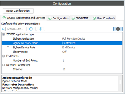

2024-09-30 5:17 AM
My device is defined as an "end device" but sleepy mode is "off". I tried with Device Role equal to "router" but the issue is still present.
Nevertheless, knowing that the device goes into sleep mode is a good track. How do you see that ? I also tried to switch from "centralized" to "distributed" but the issue is still there.
