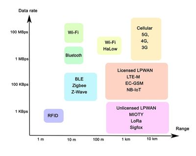

from: https://www.emnify.com/iot-glossary/guide-iot-protocols
Not sure that their depiction of "BLE" accounts for the v5 2M PHY ?
