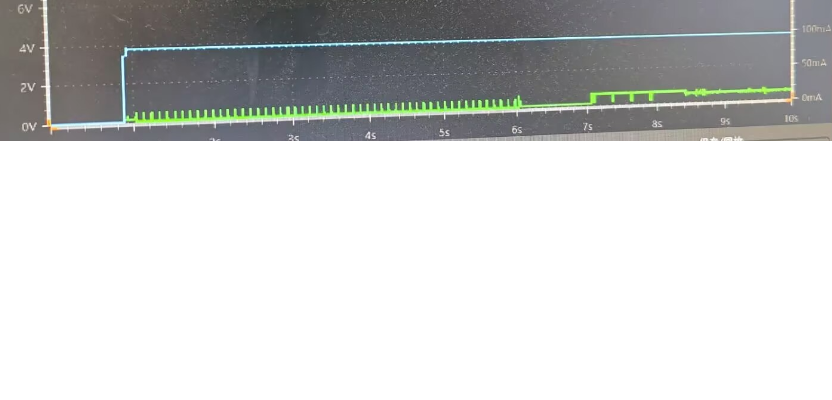

2024-10-14 7:30 PM
I provided my modified source code. Since I have no doubts about the power consumption of BLE, I have modified the code to automatically switch to Zigbee and only switch once. I also added a timer per second to create a heartbeat curve, but according to the measurement results I mentioned earlier, it didn't help.
The measuring device I use is called PowerMini. The overall power consumption change is shown in the figure, and you can see that after Zigbee starts, the minimum current becomes very high.
