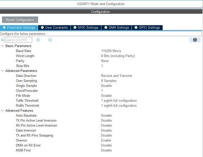

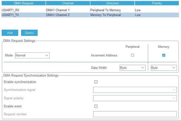

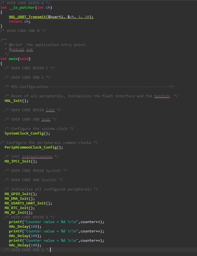

I got my hands on a Nucleo STM32WB55RGV6 MCU and tried to get a simple example with activated Zigbee and Log to run. USART1 is working fine via the debugger as long, as Zigbee is not activated in CubeMX. I tried switching on and off the recommended paramters from CFG_HW_USART1_ENABLED, but no output at all. Deactivating Zigbee results in the USART working fine again.
My configuration and (simple) code is appended below:

Please make sure to set the right settings on Zigbee CubeMX configurator, as an example you can have a look on the different examples activating Zigbee on our ST Github
Also, you have to flash your device with Zigbee M0 binary to be able to run zigbee stack.

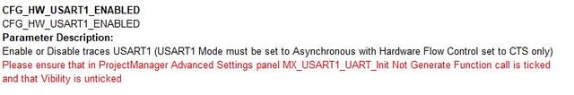

2024-08-19 8:34 AM
Zigbee SED application uses the Full Low Power mode with CFG_DEBUG_TRACE disabled by default as mentioned previously to save the consumption, You have to enable this setting to be able to activate the trace.

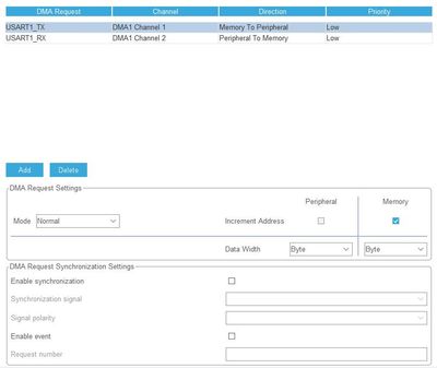

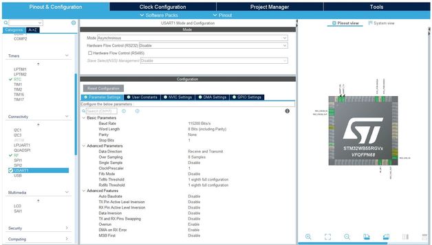

I found a possibility to read the serial output from the micromod development board.
I started with a fresh project to eliminate possible errors or incompatibilities from the old project.
First, I set up only the standard USART1 output on STM32WB5MMGHx PA9 and PA10. Serial output works as expected in this simple setup.

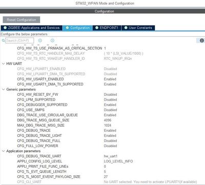

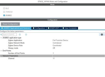

Now, I want to continue as simple as possible to get the debug traces to work when running Zigbee. For this, I set up the device to work as coordinator/reduced function device, with all settings left to standard (no sleep mode), except the ones to get the debug traces to work. The projects builds without errors or warnings. Result: no output at all, despite the serial working before.
I appended my configuration here:
I appreciate any help!

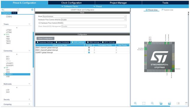

2024-09-09 3:01 AM
Hello Ouadi,
I tried changing Advanced Settings in Project Manager without success. What could be the issue of traces not being working here?
Thanks and best regards

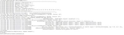

I solved to enable the traces on the sleepy end device (as mentioned in my other post) and now want to go back to the original problem of the sleepy end device not waking up after connection to the coordinator.
I appended the log below.
