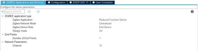

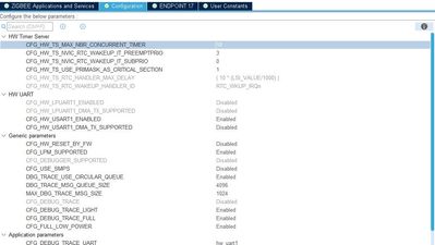

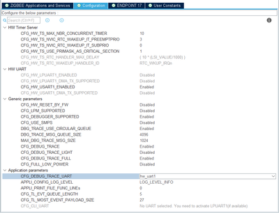

2- I uploaded the M0 binary stm32wb5x_Zigbee_RFD_fw.bin, enabled sleepy mode and and to enabled the flag CFG_LPM_SUPPORTED. Unfortunately also the logging does not work. This is my current configuration:
Best regards
2024-08-12 6:06 AM
The debug trace feature is disabled by default with the flag ( CFG_DBG_TRACE ) for applications that needs to activate the full low power mode, you may enable it manually on your code => CFG_DBG_TRACE with the desired level ( only for debug).
Best regards,
Ouadi
2024-08-12 6:31 AM

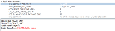

reset the options from the sleepy mode from before. I made the following settings to get the traces up and running, but I dont receive any output.
Im wondering about this hint:
Might I miss some detail here?
Best regards

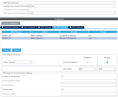

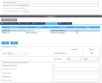

2024-08-12 8:35 AM
Could you please share your UART configuration and DMA settings ?
You need to make sure that DMA is activated as the DbgOutputTraces function uses the DMA to transmit data.
Regards,
Ouadi
2024-08-12 8:45 AM
I followed the instructions given in the configuration interface.
Best regards
2024-08-12 9:00 AM
Looking at your settings you have to disable the Hardware flow control RTS/CTS which is only used for RS232 communication.
Best regards,
Ouadi

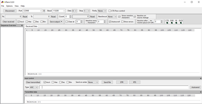

2024-08-12 9:03 AM
Hello Ouadi,
I have to apologize. I am working on a MicroMod Main Board and apparently the RX and TX lines are routed to an external connector, so I am not able to receive any logs from the device without further hardware. Is there any way to get some debug information of the Zigbee Stack via the SWD?
Best regards
