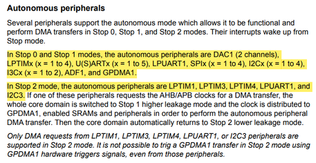

Yes, autonomous peripherals can be active in some stop modes without waking up the CPU. There are several to choose from. LPTIMx will work.
Per the reference manual:

Based on the product Datasheet , and if I understood your request correctly, it should be feasible.
You can use GPDMA1 because it can operate in stop mode and supports autonomous data transfers during low-power modes.
Consider using LPTIM or LPUART to detect your specific condition.
BR
