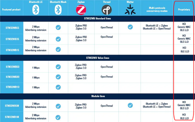

Can you please shed some more light on proprietary 2.4GHz?

@gaurav wrote:Can you please shed some more light on proprietary 2.4GHz?
"Proprietary" means you can make up anything you like from scratch!
The possibilities are endless!
