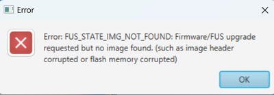

I then proceeded with trying to load the v1.2.0 FUS. However I got the following error:

This says I basically locked my processor. However none of this information is available on the Release Notes.

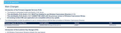

This is actually documented in the release notes related to the old revision of the cube package -
Anyway, FUS 1.0.1 was available only in the cube package version 1.1. Today there is 1.19 which does not contain the old FUS version but rather 1.2.0 which can be applied directly over 0.5.3. The basic requirement is to always use the latest versions.
For your second question, you cannot unfortunately unlock this device.
2024-05-16 11:57 PM
Thank you, that note does not say anything about which specific MCU that rule applies to, for example the STM32WBXXG series accepts the v1.0.1 and will then accepts the most recent FUS on your Github page. I do not understand why the contains of the post in the forum cannot be copied in the release note to be more specific and also includes the processor variant type.

2024-05-17 12:48 AM
You are right, that release note does not state that, sorry for that. Anyway, it is stated in the official application note for FUS How to use STMicroelectronics firmware upgrade services for STM32WB MCUs - Application note and, on the Wiki, STM32WB Firmware Upgrade Service - stm32mcu.
