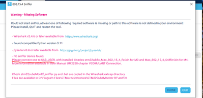

Hi Community,
I tried to connect and use 802.15.4 sniffer function from CubeMonitor-RF app. I stopped at the very first step. Once I opened the CubeMonitor-RF program, it said I need to install wireshark, after install the wireshark, the warning message is not changed. What should I do? Also I know how to install the binary stm32wb5x_Mac_802_15_4_fw.bin into the M0 core, however, how I can install the binary Mac_802_15_4_Sniffer.bin? There is no information about the start address for this binary. Do we have to use FUS to install this binary? When I tried to this install with FUS, it failed.
How I install the "pyserial?" I am lost how to do this.
Thanks in advance,
YJ

Hi STTwo-32,
The document said " connect the STM32WBx5 Nucleo board to the host computer using the USB_USER connector." There are two micro-USB port and one is STLink port the other one is USER-USB port. Is the statement saying I have to connect to the USER-USB u-USB port. If I do, there is nothing happened.
Is it right we need to connect USER-USB not STLink-USB to use Sniffer?
