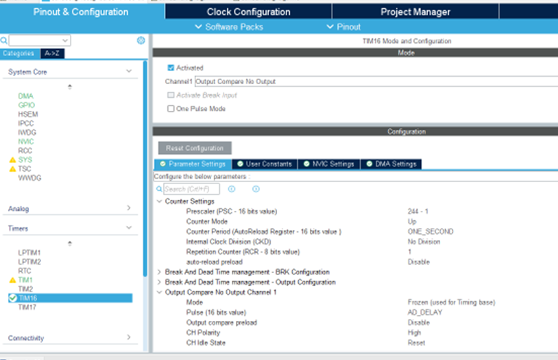

TIM16 on STM32WB55 has a setting for (see below)....My ISR goes off every 1 second....I am under the impression that using this 'event' (ie RCR) that I can generate interrupts every 2 seconds or 3 seconds, etc. I am not sure what the value of this is because I could just as easily create a variable to count how many times I go into the ISR??
