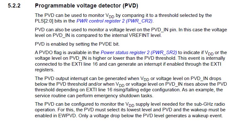

We are investigating. Note anyway that a more accurate and more power-efficient way to detect voltage to enable or not sub-Ghz radio is to use the PVD feature.
Please look at chapter 5.2.2 of RM0461
