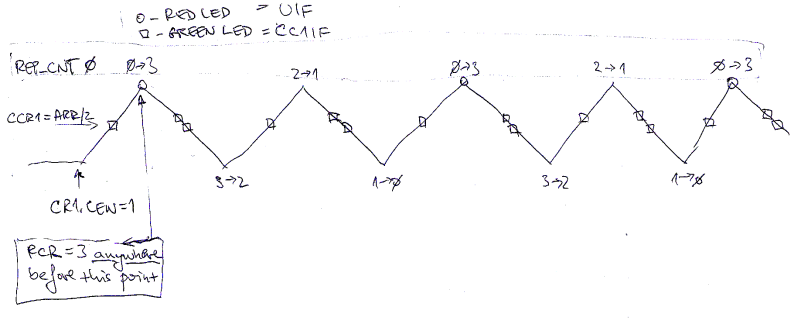

2024-04-15 9:43 AM - edited 2024-04-15 9:50 AM
[EDIT] I've just dug out an old thread where I analyzed this question and posted it here... just to realize it's the same thread you've posted in the initial post.
Isn't the diagram I posted, and my whole dialogue there, clear enough?
As @Sarra.S wrote above, as RCR is preloaded, it's not taken into account until the first Update occurs after it's been written.
You can adopt the program I posted there to 'F4xx and experiment yourself.
2024-04-15 7:06 PM
Hello @waclawek.jan ,in your diagram,1->∅ should generate an UEV , and the RCR in my opinion should be auto-reloaded to 3 , why it is reloaded to 3 the next overflow?
Jerry
