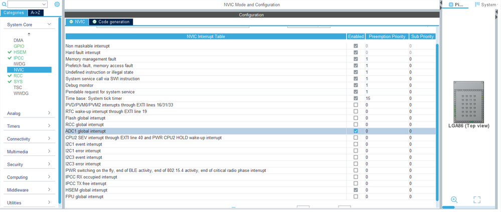

So, it appears to me that, the problem accrue when trying to run the adc within a task in the sequencer. If that is true, How to solve this problem?
Below are the code of ADC1 and System Clock Configuration, also a foto of the the NVIC Interrupt Table.
