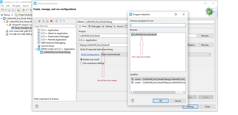

@Danish I debug the normal interrupt and took the value on the live expression. but the problem was faced it the elf file error. so I re-install the cube ide software and run it. this elf file was generated. what problem occurs, why was the elf file not generated. do you have any other alternate method?

Can you post a screenshot including some of the error messages you get. Maybe they don't translate very well to/from English.
And the result when you build your project.
When you build your project, STM32 Cube IDE should generate an ELF file unless either:

Some time did not create the elf file on stm32 cube ide. why this file was not created kindly explain. I attached that image above.

Learn capturing screenshots normally so that those are not resized to ridiculous 11472x5528 pixels. Screenshots should not be resized at all!
