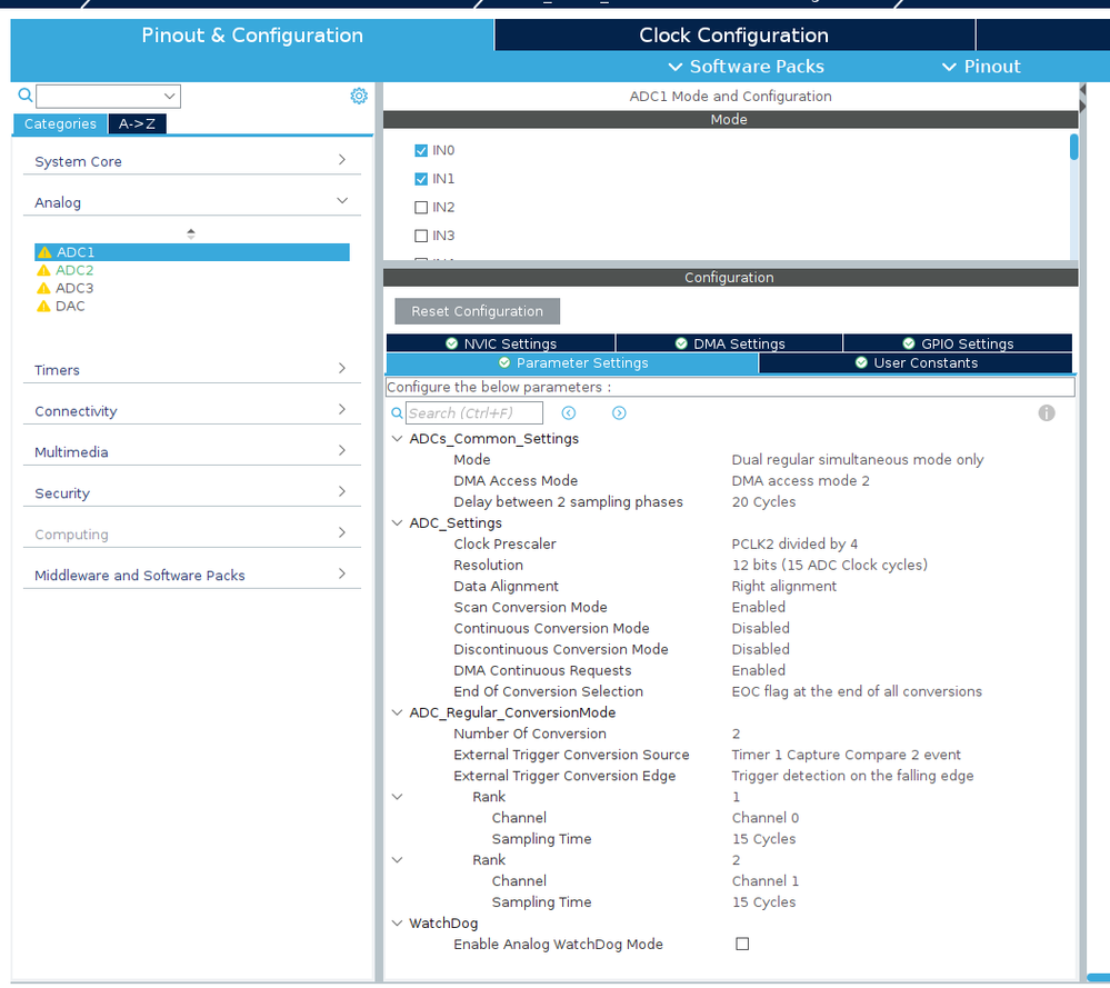

from recently I have a problem using STM32F407VGT6, moreover, I am unable to get consecutive conversions in the DMA buffer. For example I want to use Dual Regular Simultaneous ADC mode to obtain results from 4 channels (2 in ADC1 and 2 in ADC2). However, when I start my application only the first iteration is obtained, second part of the buffer is never filled(i.e. CHN3 and CHN4 are never read if CHN1 and CHN2 are rank 0 in ADC1 and ADC2).

hadc1.Init.NbrOfConversion = 2;
hadc1.Init.DMAContinuousRequests = ENABLE;
hadc1.Init.EOCSelection = ADC_EOC_SEQ_CONV;
if (HAL_ADC_Init(&hadc1) != HAL_OK)
Error_Handler();
/** Configure the ADC multi-mode
multimode.Mode = ADC_DUALMODE_REGSIMULT;
multimode.DMAAccessMode = ADC_DMAACCESSMODE_2;
multimode.TwoSamplingDelay = ADC_TWOSAMPLINGDELAY_20CYCLES;
if (HAL_ADCEx_MultiModeConfigChannel(&hadc1, &multimode) != HAL_OK)
Error_Handler();

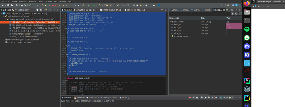

I can confirm that Callback is being called on ever Timer1CC2 event but only 2 out of 4 values get filled:

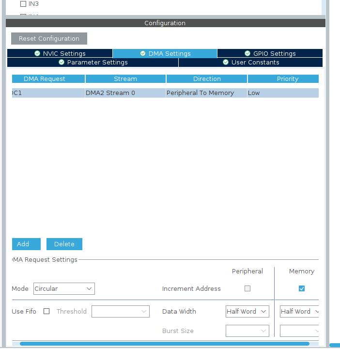

Data width should be word, not half-word.
2025-11-30 6:53 AM
2025-11-30 10:09 AM
Ohh thank you so much, this resolved my issue.
Quick note: I am unable to change it in CubeMX I have only Half-Word option, so I did it manually. I don't know if this is a bug or what.
Many thanks:))

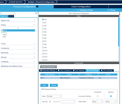

2025-11-30 1:07 PM
No problems changing it to Word in STM32CubeMX here.
