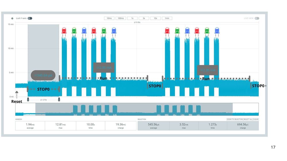

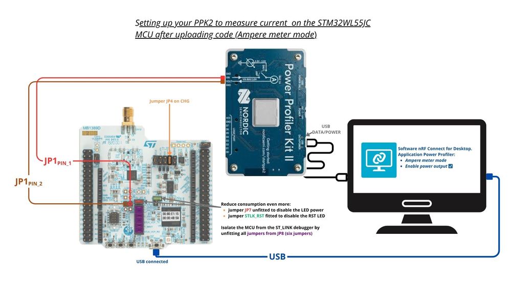

Hello again!
After changing some of the equipment: Otii3 / Otii Arc Pro → nRF Connect for Desktop / PPK2)
and configuration: measuring using E5V / GND pins on CN7 → PIN1/2 on jumper JP1,
at last, I finally managed to get the hundredths of µA in current consumption during STOP0 mode.
I misunderstood what I was measuring: using E5V/GND pins on CN7 allows to record data on current consumption for the whole board (NUCLEO-WL55JC),
whereas using PIN1/2 on jumper JP1 measure the current consumption for the MCU only (STM32WL55JCx).
Below is how I set up my PPK2 (along with the software) to measure the current consumption:

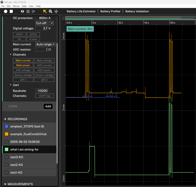

Unfortunately, it turns out no matter what entry mode (WFI/WFE) I choose, the result is still the same, see screen capture below:
• In green is the current consumption I am aiming for (which I obtained through an error on my wiring: the ST-LINK was still plugged on the board, resulting in a short-circuit).
• In blue is the simplest example (PA0 as an External event, falling edge) with the stop mode entry as WFE.
• In orange is what I got from following the example on GitHub (the dual core one, even though I want a single core version, I tried it anyway).

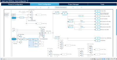

I don't know if I'm supposed to wait for a special flag to be raised/cleared, or if the problem is from elsewhere. Maybe the clock configuration (?), I used the same for every test, see screen capture.

2025-06-10 2:40 AM
Hello again!
