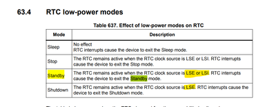

The device cannot enter on standby and shutdown mode or cannot exit?
Please refer to the example below:
Note that The RTC remains active when the RTC clock source is LSE or LSI.

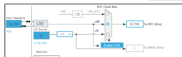

2025-07-30 8:40 AM
