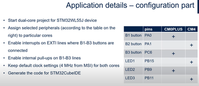

I understand that this feature has not been implemented. Could you suggest another solution, then? In this course (Youtube), proposes the configuration below.
This is my first study to work with the cores, and I’m just getting started, so it’s really a basic approach. I truly appreciate your support.
